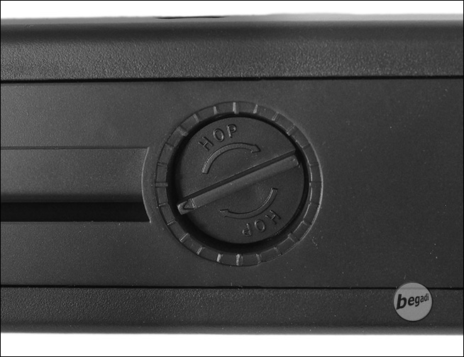

lukasz123456 Posted February 20, 2018 Report Share Posted February 20, 2018 Witam panowie gdzie w replice karabinu mb4402 znajduje się regulacja hop up? Quote Link to post Share on other sites
mikadorus Posted February 20, 2018 Report Share Posted February 20, 2018 To nie temat o tej replice. To zupełnie inna konstrukcja niż mb-01. https://www.begadi.com/well-mb4402-sniper-rifle-roedale-deluxe-edition-frei-ab-18-j.html Quote Link to post Share on other sites
